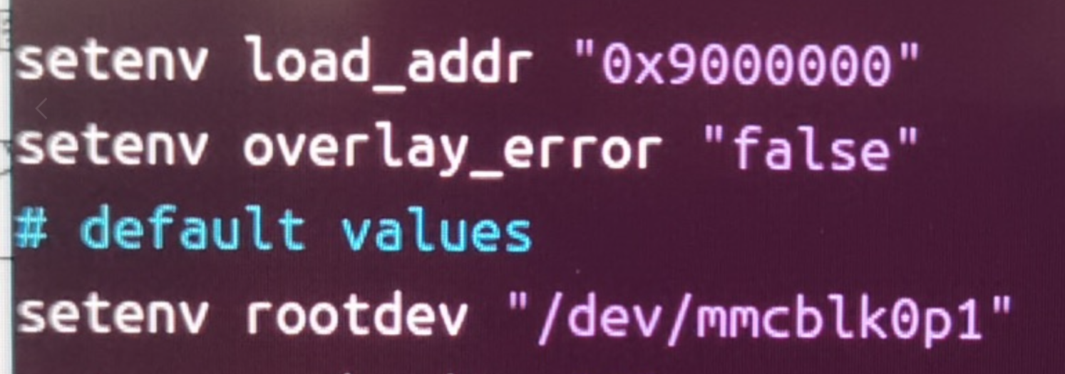

          @mainbord same here, sadly Armbian isnt booting or else i would already be using it instead of the supplied distros
          G 2 Replies Last reply Reply Quote 0
          • G
            george @Momo 0
            @Momo-0
            The official default configuration of ARMBIN's loadaddr and optee conflicts and needs to be modified to 0x200000
            M 1 Reply Last reply Reply Quote 0

              • M
                mainbord @Momo 0
                @Momo-0
                I did it
                change address 0x200000
                build
                burn it to emmc
                profit
                Linux coolpi-genbook 6.18.0-edge-rockchip64 #1 SMP PREEMPT Mon Dec 1 01:42:10 MSK 2025 aarch64 aarch64 aarch64 GNU/Linux
                wireless works
                no sound
                No usb-c
