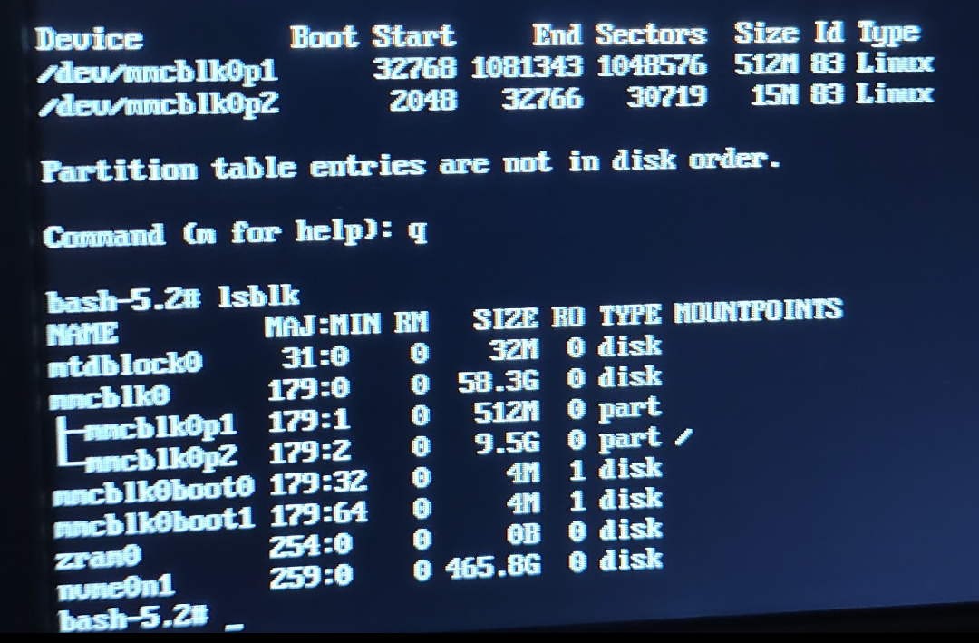

    • RE: Any other distro booting?
      @george Something went wrong in Void Linux. It seams that the flashing was not successful. First boot is ok but lsblk and fdisk are showing different sizes of the partition mmcblk0p2.15 MB in fdisk and 9.5 GB with lsblk. After reboot the 9.5 GB partition is gone and Void is trying to access the 15 MB partition
      With the Ubuntu image Arch and Void Linux are booting. Void Linux breaks something after update so it won't boot after a reboot. In Arch Linux I can't get GPU drm to work. Only LLVM so I can't start any Wayland stuff like sway or labwc.
      It seems that after rebooting Void the root partition is deleted. Size only 15 MB.
