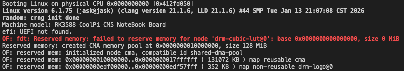

      Mainline Linux supports rk3588 and almost everything works out of box (except power-off). I added some modification to Linux Kernel in this repo. Just run build-kernel.sh (dependens on llvm and clang) and copy extlinux.conf, Image, dtb file and extract modules into /lib/modules.

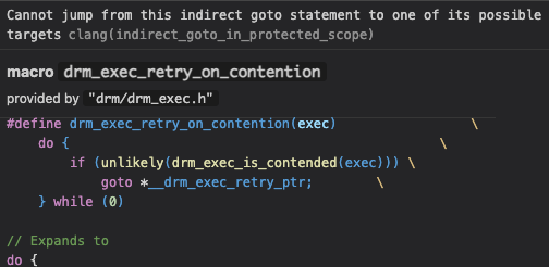

      2. cannot jump from this indirect goto statement to one of its possible targets。在此之前我并不知道gcc还有这样的拓展,这个问题出现在drm相关的代码里面,我用比较丑陋的代码暂时处理了,以后再看看mainline kernel是怎么处理的。

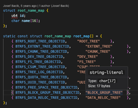

      3. 数组大小问题。eda8b240-93b8-48d7-ae1d-373e948aaa1b-6293296cb735f5889097a827b4504e1f.png
