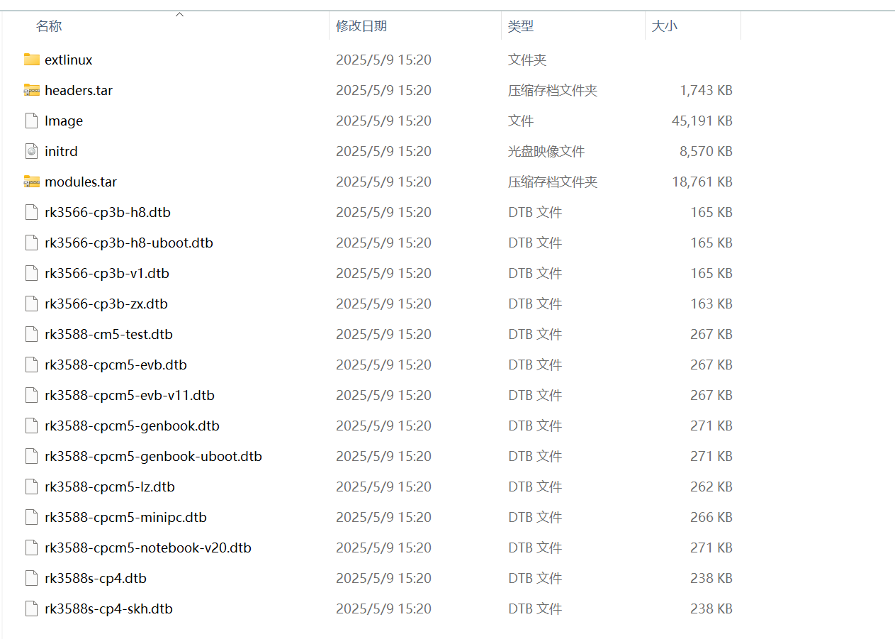

                            • G
                              george @zehui
                              @zehui
                              The use of cloud storage images requires updating uboot to the latest version. Currently, RK3588/3588S uses a unified image, and machine models are distinguished in uboot. As for the partitions of the image, they are boot and rootfs. Boot stores kernel related files.
                              As shown in the following figure:
                              Z 1 Reply Last reply Reply Quote 0
